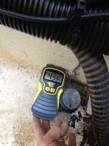

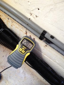

Seal them up . . . if they are really wet, then you may have to let them dry out a bit. Epoxy or JB Weld would be good.
Here are some pictures of the testing that I did on my boat. Just had to drill two holes the with of the probes on the meter.
These are a couple of test areas that I did on the bulkhead that the surveyor said was wet. . . . it sure was. Typically, you will find high moisture in the lower parts of the structure.
