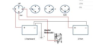

Battery switch is a good start. The only thing that should be powered with it OFF is the auto bilge switch/pump. At the beginning of the season it is a good idea to make sure that the alternator is actually charging the batteries and also check for any parasitic draws, with older boats you never know what was added by previous owners.
