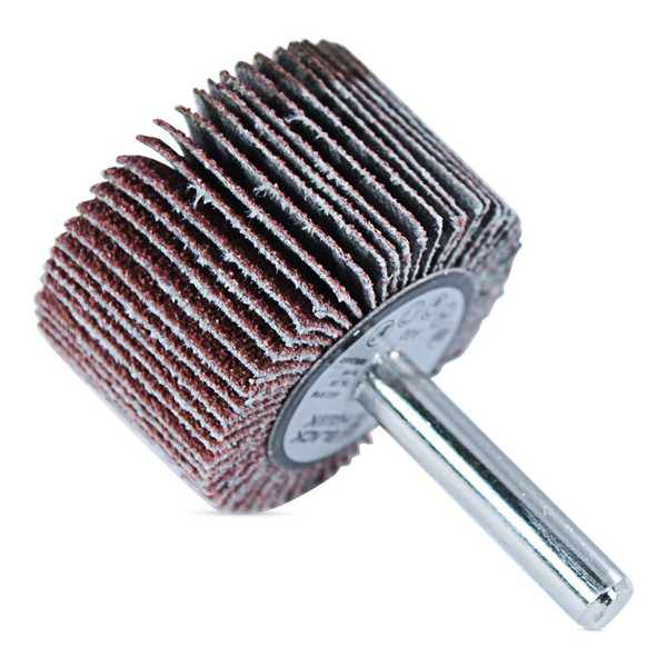

Maybe clean up inside of damper with a flap wheel to remove burrs and clearance it a little

Brand new never been used crank, don't know what a flap wherl should be able to do

Seemed like from your comments that balancer was more difficult than it should have been to remove. use a flap wheel and die grinder to clean up ID of balancer and open it up hair so it goes on easier. Possible its been on and off before someone may have beat it up…
use them all the time at work on machine repairs and overhauls when things have some wear or damage.

yep, check it for burrs, clean any crap out of it, but DONT GO NUTS and make it too loose..... these and the scotchbrite discs for a die grinder have fubarred more machined fits in the hands of an amateur than anything else......
