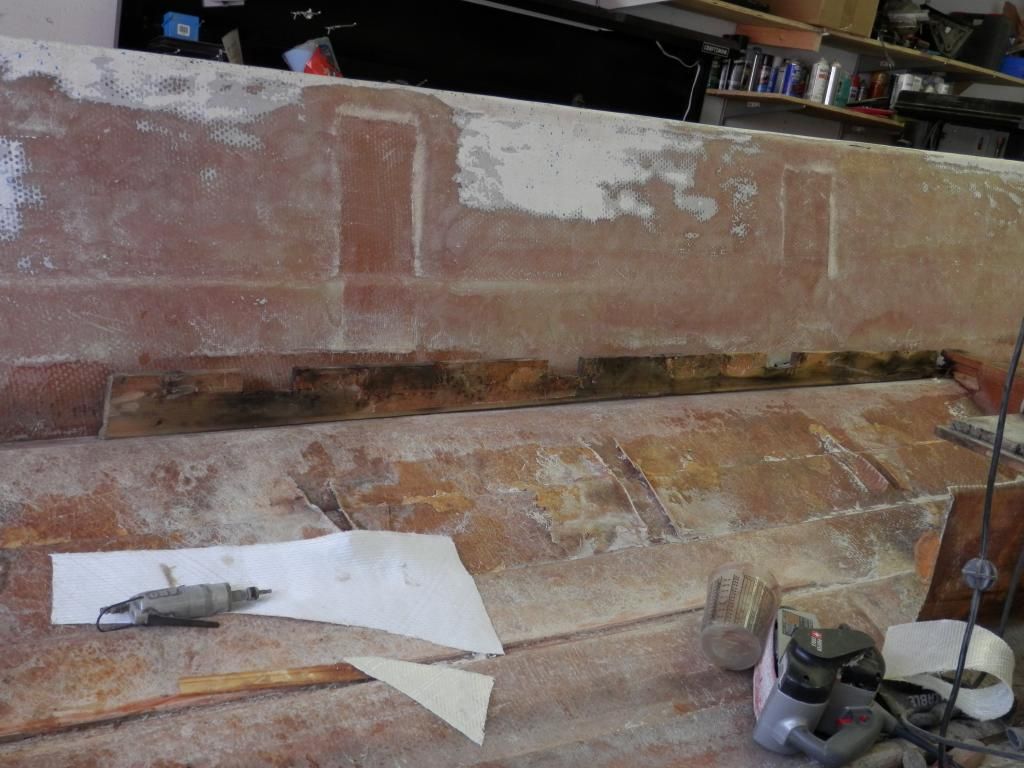

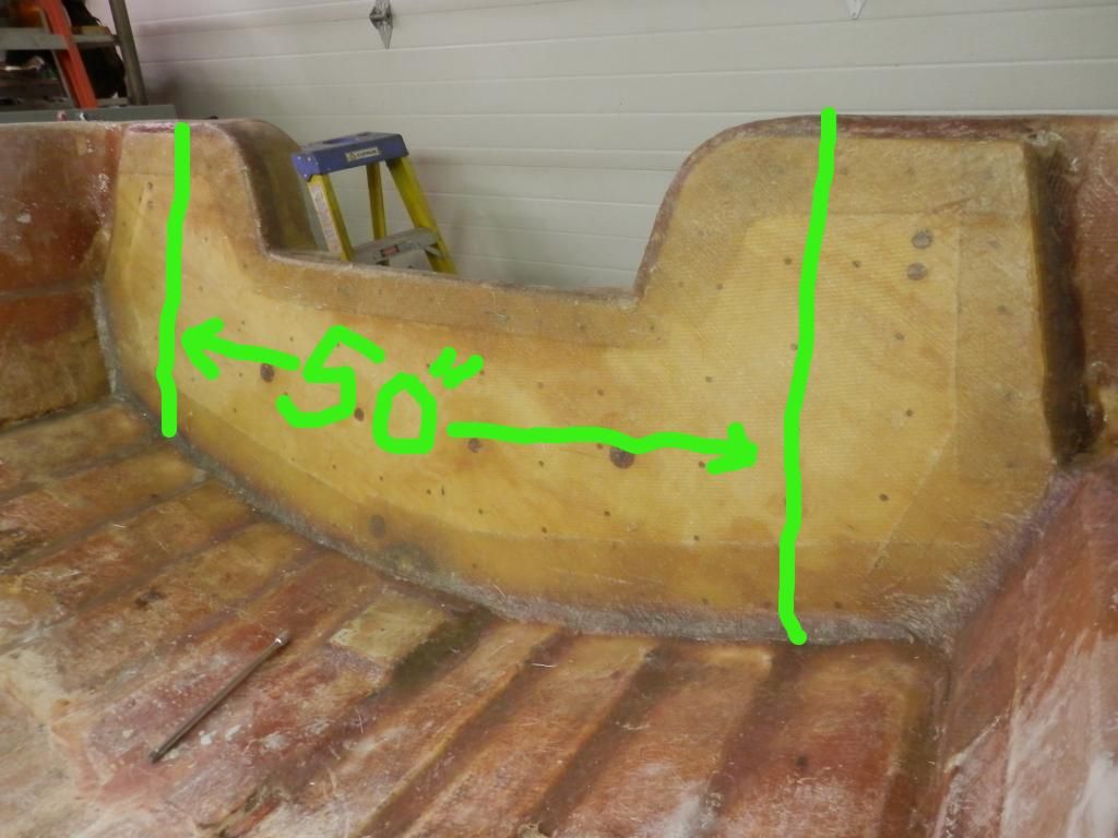

Ok all fixed uo now back to the 1708 Doing the whole transom in one piece one more time this time I think I will go 1%
ahmincha
Jul 21, 2012
1,512
Re: Deck coating / Turned complete restore
My 1708 is 50" wide will it hurt or weaken anything if I run it as shown in picture and do the to ends separate
Woodonglass
Dec 29, 2009
25,929
Nope! No problem at all. The tabbing out onto the hull is the critical factor the rest is more water proofing.;)

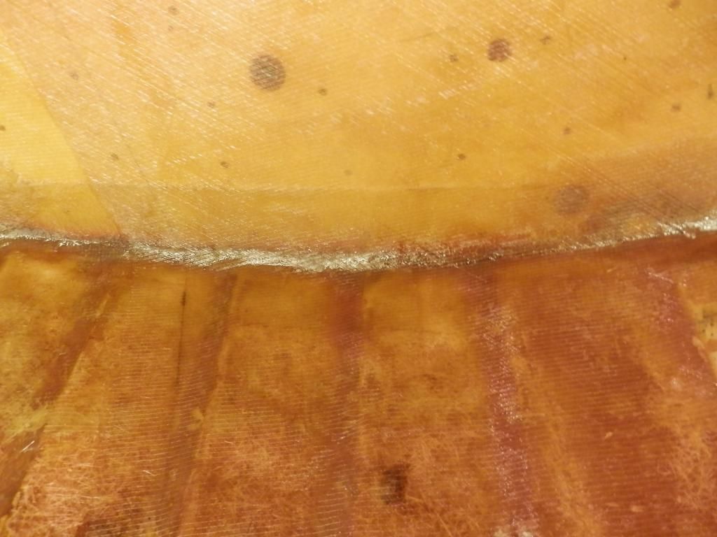

ahmincha
Jul 21, 2012
1,512

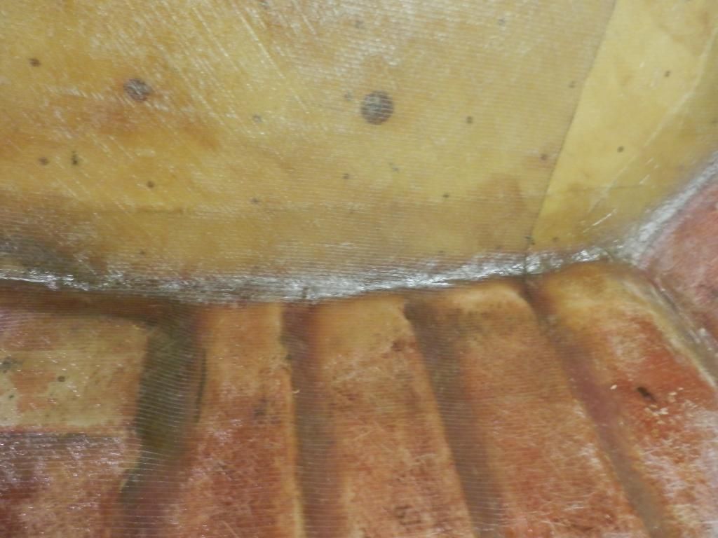

Ok center 50" done 12" tab to hull few minor small air bubbles I hope they are harmless
Woodonglass
Dec 29, 2009
25,929
You can dremel them out and fill em with PB!!! Do a 3" over lap on the side tabbings to the hull sides and you'll be GOLDEN!!!
ahmincha
Jul 21, 2012
1,512
If this boat ever needs another transom I am junking it. I don't want to be the one that has to grind out all the pb I have put around this transom

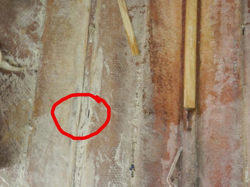

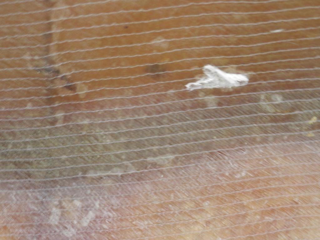

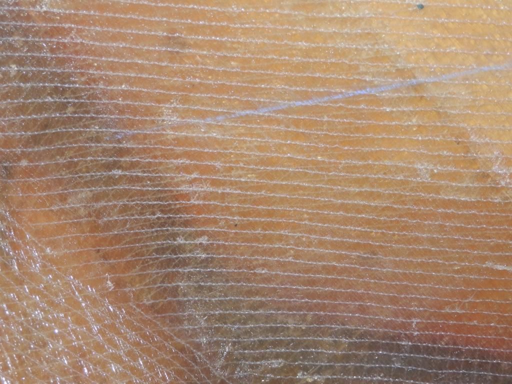

ahmincha
Jul 21, 2012
1,512
is this air or just fiberglass it is not raised Wog told me to grind out the air bubbles and fill with pb I just want to make sure I am doing it right
tallcanadian
Sep 7, 2006
3,250
By the time you have to redo that transom you will be six feet under. You won't have to worry about it then..;)
ahmincha
Jul 21, 2012
1,512
Yeah I figured I am over thinking it
GT1000000
Jul 13, 2011
4,916
Keep in mind a couple of things when it comes to air bubbles...
1- You are going to be putting a lot better construction techniques than the factory and they managed to have it last this long...
2- You will be putting a lot of blood, sweat, tears and cash into this boat and are probably going to take MUCH better care of it than it ever had before...one way will be to make sure it is put away nice and dry and covered, with the drain plug removed and the nose held high, after each fun filled excursion...
3- The main concern as I have learned with air bubbles in the fiberglass are two fold...IF they are huge, which yours are NOT...it could compromise some of the strength...AND...since nothing is really waterproof, except maybe sea creatures...IF the fiberglass remains submerged for looooong periods of time, water may eventually find its way into the bubbles and then into the wood...in which case you should refer to 1 & 2 above...
I think you have done an outstanding job installing the transom and the rest of the build will be just as good or better!

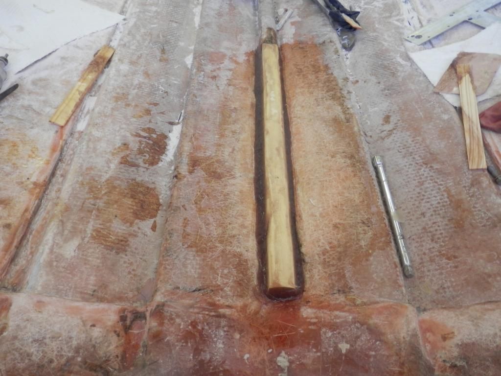

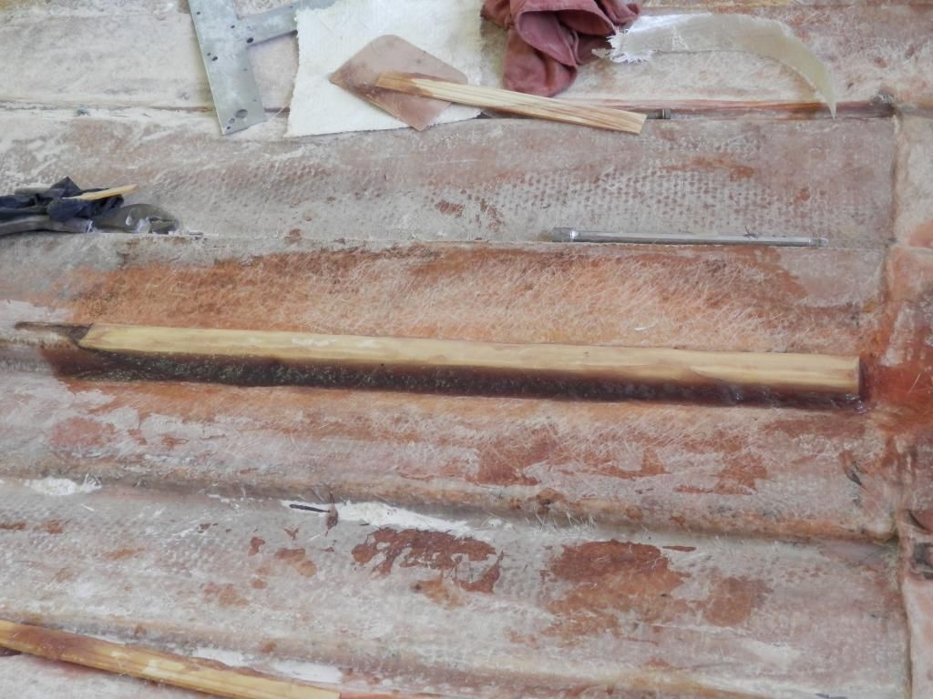

Well moving forward I set the keel board that was rotten
Woodonglass
Dec 29, 2009
25,929
I don't see nuttin to worry about cept bazookas. Maybe

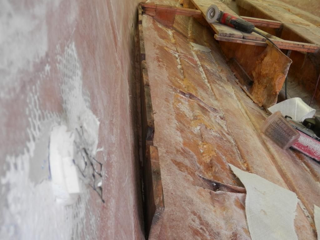

Ok so I am moving on from the transom. this is the side boards that hold up the deck structure and the sides of the deck. I am obviously going to cut new ones then my plan is to coat them in resin csm pb them in on the side next to the gunwales I do not think I can tab them in would coating them with pb be sufficient originals had nothing

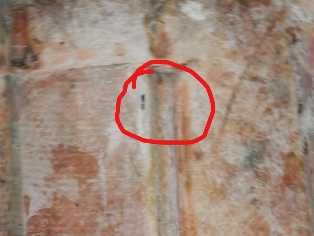

I was wondering wog told me how to fix these grind thrus in my hull. Since they are so close to the bulkheads for my full tank. That i will be using pb to set the bulk heads and 2 tabbing s will that be enough to repair. Or should I repair first then go on as usual
Woodonglass
Dec 29, 2009
25,929
Put some Tape on the outside to hold the OOZE then fill with PB. The tabbings will take care of the rest. That's STILL my Opinion but Hey, NEVER trust an Old Dumb Okie!!!!;):D
ahmincha
Jul 21, 2012
1,512
That's what I was thinking just wanted to make sure I didn't need to do the repair then do the tabbing . Thanks wood
