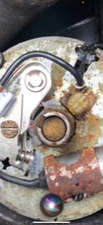

So I gap my pints at 22 and the dwell read 55 !!!!!! WTF and then I closed the gap and it did not help. Another thing I noticed was the lobes are not sharp the are rounded it that normal on a merc?

So guess what I DID NOT connect the dwell meter properly. RED to coil neg and neg on the dwell meter to ground OPPS

I did the Dwell and LOL I was of by 3 33 instead of 30. So today all went well trying to burn off gas before winterizing and after 25 min of cruising14 mph I decided to head in an she stalled. I restated and 15 seconds later died. Restarted and died after 10 seconds and then 5 seconds. I waited 5 min restated and she ran for 1 min and then died. The SAME EXCACT Thing happened last year when trying to burn off fuel. WFT!!!! so I get to the dock and like last year restarted and she ran for 15 min LIKE LAST YEAR!!! During the regular season I don't cruise around I drop in drive 15 min anchor and sit for 3 hours. So what is causing this ? Overheat ? I changes the coil to a 3 ohms coil that can handle heat better. Do I need to vent the engine compartment better? I have the side vents the 4 inch ducts and the blower.

Why don't you just put an electronic ignition on your engine and be done with points and condensers. Electronic ignitions are easy peasy to install. Most people with old engines do this because the lobes on the distributor round over time and it is difficult to set the dwell correctly.

I agree. I switched both my 3.7s about 6 years ago and glad I did. You definitely get easier starting and I'm not screwing around with points anymore. I do keep an extra module on board because I've heard they aren't reliable but it's been 6 seasons and I haven't had any issues
