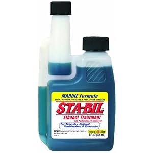

Speaking of Stabil, I got the red stuff at the local bait shop for when I put regular gas in, but then I found the black stuff at Bass Pro Shops which says it is specifically for Ethanol treatment.
Red:
Black:
Is there really a major difference between the two? The black requires about half the amount the red does according to the directions, but it costs twice as much.

There have been numerous spirited iboats debates about the viability of Stabil type treatments, but most (there are still a few skeptics) at least agree on its value as a stabilizing additive. To that end, the red will be fine. Pretty much any additive that prevents phase separation will benefit your fuel system.
