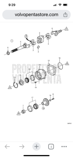

So the snap ring 10 holds that in place? Haven’t found that yet. Time to tear it open. 11 is the seal which you can see in the pics above are junk. Hoping I can maybe get a new seal and snap ring and hopefully the bearing and gears aren’t junk… highly unlikely I know.

So the bearing is gone. Snap ring goes on the inside lip of the carrier housing and holds seals/bearings in place.
The yoke is indeed held into place with a washer and bolt which obviously sheared off.
Gears look good and from what I can tell the metal shavings are from the bearing.
Is it possible to rebuild just the yoke carrier housing components? I would assume I would need a bearing puller, but not sure about the gear in there… I am assuming and pretty sure it is pressed in there. Anyone done work on just the yoke housing and bearings/seals inside?
Trying to dodge a bullet here but any honest opinions would be appreciated.
