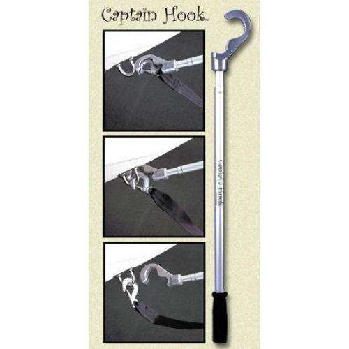

Iboats doesn't sell these, I checked...
Google will be your friend in finding it cheaper.
When loading, I hand my wife the dock lines and she (and the boys) walk the boat up the trailer for me. They stay completely dry as they're on the dock. I'm in the water and connect the strap to the bow eye and winch it in the last few feet. Totally normal for the ramps I'm on, no other way around it with my boat/trailer combo. Power loading where I am is a no-no.

My advice for your situation, tagging onto the advice already given . . .
- Trailer guides at the rear portion of the trailer, set a bit tight (maybe 1" on each side) to help center the boat.
- Winch hook device, so you can grab and connect the winch strap from the bow of the boat.
- Lower the bunks/rollers as much as you can, for shallow ramps. Not much of an issue for steeper ramps.
- Ladder/walking boards attached to the forward part of the trailer, so you can step down from the bow and get to land.
- Wheel chocks under the rear wheels of the tow vehicle, just for safety, since you are on the boat and not by the tow vehicle.
