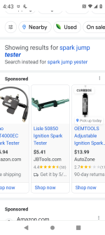

Yes, man overboard switch could cause spark loss. Best to purchase a spark jump tester.
