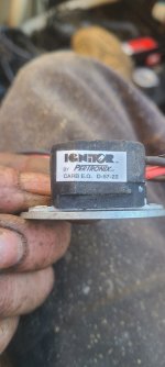

it's a pertronic ignitor D57-22 ignition module
I swapped the button out of the second (running ) motor and seems to fit alot better and does not spin on armature like the other one did but still won't start ..
going to swap out coil from other motor and try that and I also have a spare petronix ignitor to try ..
running out of ideas !!!.
does anyone have a picture of the exact location of the rotor button when at top dead center pretty sure i have it right but service manual is pretty vague in the description of placement just says to front of engine .
I'm attaching a pic of the ignition module

FWIW....I have had 100% of the pertronix kits I ever bought fail.
I have never been stranded by a set of points.
however prior to ripping anything out, simply ground and unground the coil repeatedly and every time you unground, the coil should fire.
