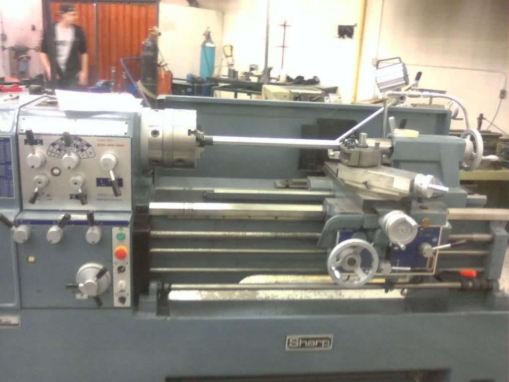

I bought one from EBAY. and it was bent slightly.
So I made one using a friends lathe and the dimensions Don provided.
It took me about an hour on the lathe, $20 for the 1.375" bar stock, and 2 bottles of beer.
Yes they're the same. OMC/Merc/etc
DO NOT skimp on alignment......... when you ruin the aluminum splines in a coupler, you have to remove the drive(s) & engine(s) to replace them.
