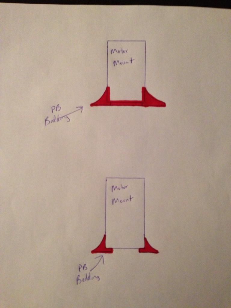

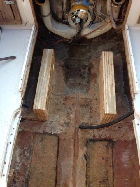

I got my new mounts glued together and ready to go next I will cut the bulkhead and get that in place but I have a question about the part where Im supposed to hold the mounts off the hull.When I do this am i supposed to bed the whole underneath or just on the edges.I attached a picture to understand my question. Could anyone tell me wich way is correct.Sorry for the stupid question just want to make sure I do this right.Thank you for any help
TJ
