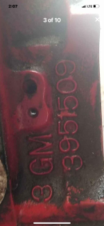

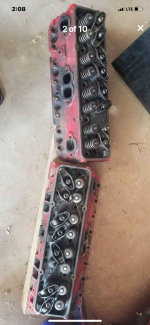

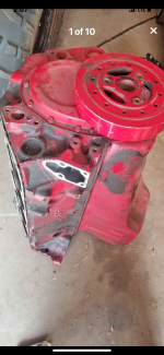

400 sbc stroked with forged rods… this too much ??

400's with Siamese bores will be fine in a boat. However they are externally balanced. So you need the right flywheel for it. If it's stock, the drive will survive.
Make sure it does not have any go-fast parts. It needs a truck cam or boat cam
