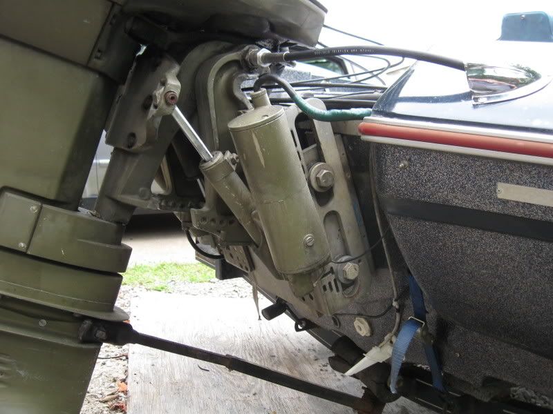

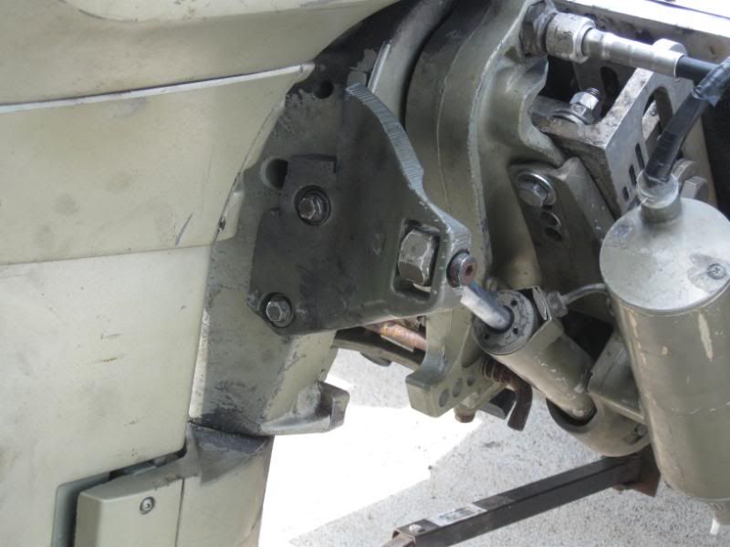

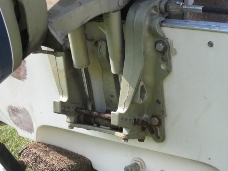

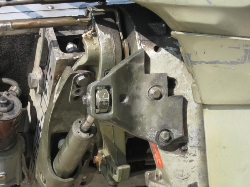

Can you guys look at these pics and tell me what I`m in for and if I could still use the trim unit that is on the boat now? The engine in the pics is being replaced.

Trim unit is possible....
IF you like drilling holes into your steering/transom bracket.
AND you have the knowledge to remove and reinstall the bracket.
Mounts and screws may break during the disassembley. The steering tube would be the hardest part to remove.
But, thats only if you have the clearance between the bracket and the exhaust housing on the 70hp to install that lifting plate.
BigB9000
Dec 5, 2007
1,154
Re: Engine swap advice needed.........
I would just pull the unit off myself. Although, I can deal without PT&T.
Interesting design though.
It looks like its more of a Power Tilt unit than a trim. The angle for the hydraulic cylinder doesn't seem to be ideal for pushing a boat.
And I would never trust that attached plate.
Also, your straps could be better. I recommend a ratcheting type, and 1 1/2" thick.

The PT&T unit will transfer with little modification. I don't see why the power lift unit would not transfer just as well. If it has them, you would need to switch out the tilt assist cylinders for regular shocks on the 70.
The only problem that I see is that the PT&T pump is of a kind that is difficult to replace and service.

Ezeke, I think you are correct. I does appear that it will bolt up to the trim unit.

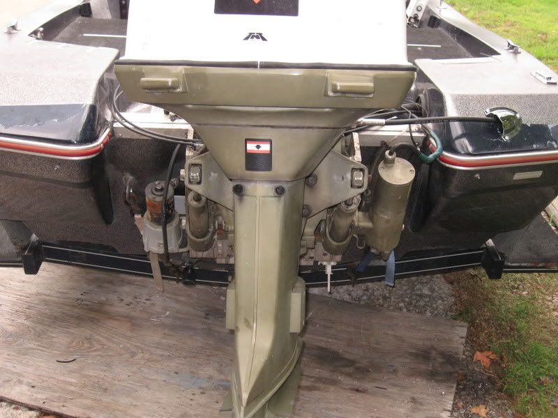

Heres a pick of the nnew motor:

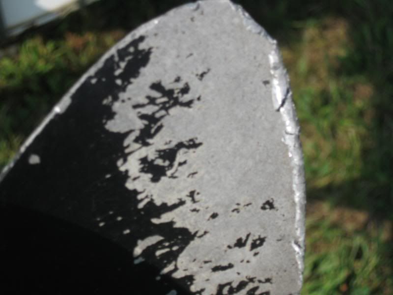

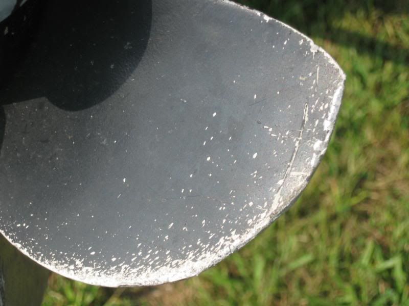

Also it looks like he dinged the prop, does this look real bad?

The stern bracket looks good.
What pitch is the propeller? Looks like it was in the sand. A prop shop could dress that up and balance it if the price were right.

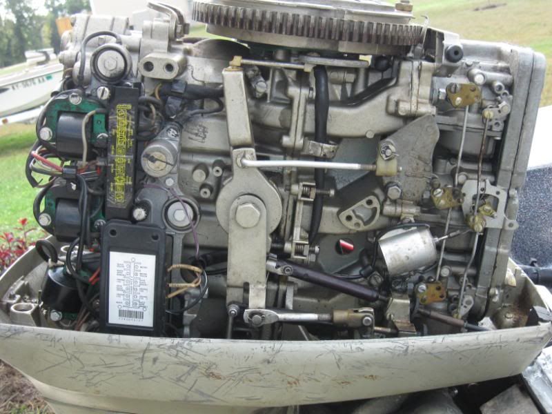

I looked at the model number on the stern bracket and it is (65273S).
this seem s to be a 1972 65hp engine.
The air silencer has a 1976 sticker on it along with the timing info. The boat was a 1977, and the engine cover says 70HP
What gives??
ezeke
Sep 19, 2003
12,532
Don't rely on the stern bracket label; see what's on the welch plug on the engine block. Is the motor electric shift? The same stern brackets were used on many models well into the 1980's so it could just be one that was replaced.

The number on the welch plug is:
Top #
70673D
Bottom#
J001251
I really need to know the correct engine so I can get the right service manual and parts.

No stock tell-tale on that motor. I strongly suggest a new impeller so you know where you're at and don't fry it. Tell tale is very easy to add to this motor, if you want it. Same motor as mine.

Well, got the engine swap done. Had to modify the lifting plate for the tilt unit. all in all, was pretty stright forward.
