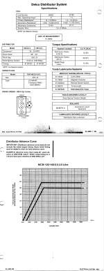

Also according to the image below with points this engine (1988) should be 6° base and a total spark advance of 35° at 2000 rpm would the total spark advance still be relevant with the est
