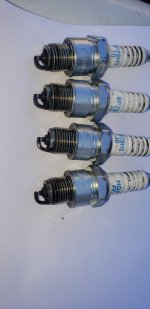

I ran the motor on the trailer, and I noticed that this problem is occurring all of the time, not just after 30-60 minutes. I guess that I did not notice the problem for the first 30-60 minutes on the river, becasue I was at least 1/4 throttle for the first 30-60 minutes, and did very little idling. So , I am changing the description of the problem to "will not idle reliably at any time". One thing that I noticed is that toggling the choke on and off every few seconds will keep it idling. In my mind, that means that the engine is not getting enough fuel. I am attaching attaching a photo of all 4 plugs. The plugs were pulled after I toggled the choke on and off. So, I am not sure if that will effect the spark plug diagnosis.

Now it's time to figure out whether it's spark or fuel. Personally, is get rid of those plugs and buy champions but others will disagree. Either way I'd start by doing a spark JUMP test and if tests fine go on to fuel.

Spark checks out good. In my mind, it is not getting enough fuel. Any introduction of additional fuel in to the intake, either by spraying, or by choke, keeps it running. It does not sound like just one cylinder that is bad causing the problem. It seems uniform across all 4 cylinders.

Spark plugs are BOTH black and unburned oil. Check the cylinder head temperatures of all cylinders. It looks like your thermostat is keeping the engine too cold.
I use 1 Heat Range hotter than standard. I use NGK standard duty. No Iridium needed.
New CORRECT sparkplugs first. Runs much better ? Then starts same old problem. Thermostat is not holding correct temperature.
It may not have been up to operating temperature when the plugs were pulled. I was toggling the choke on and off, in order to get it to run.
