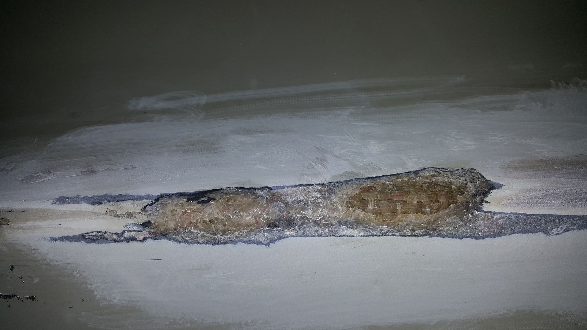

hello everyone, been awhile since ive been on the forums ! just picked up this little ranger bass boat that in great original shape..... except for the beach rash, keel dings/gouges ..... transom is good and dry (drill test) same as the stringers. whoever had the boat before me hit the trailer while loading by the looks of it and caused some good dings and gouges (sp) ? anyway they used something to fix (fix used loosley here) it that is ugly as all get out but it did seal it so i ground that all off and now have it down to fiberglass more so than the picture shows..... and just trying to figure out what is best to use on this repair ? epoxy or poly as im going to re gelcoat it when done ..... any and all help is appreciated and thank you in advance :)

Then Epoxy is out of the question. gelcoat will not adhere well to epoxy. Poly resin will do the job just fine. Try to post some close ups. You might want to add few layers of 1708 glass but I can't tell from the picture

deep, thanks for the response.... i am planning on using csm and 1708 layered to fix it then gecoat when done is the picture not showing up for you ? i have 1 thats about as close as i can get and keep it in focus...

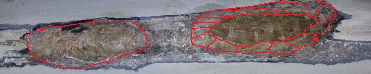

I would investigate the areas I marked in red a little more. On the right, this yellow color could be a loose/dry laminate. If so, grind it off. I would also grind a little more on the left until you reach a good flat fiberglass.
No need for CSM, 1708 already has a layer of CSM in it.
Trace the deepest area on a transparent film and cut a piece of 1708 to fit this area and so on. Start with the deepest layer followed by the shallower and so on.
Finally, sand, fair and apply your desired finish

What did he fix that damage with originally? Looks like chocolate pudding mixed with epoxy!

im not really sure what it was i think it was an epoxy of some kind or maybe bondo but not really sure , it was hard as a rock and a pain to remove ! lol

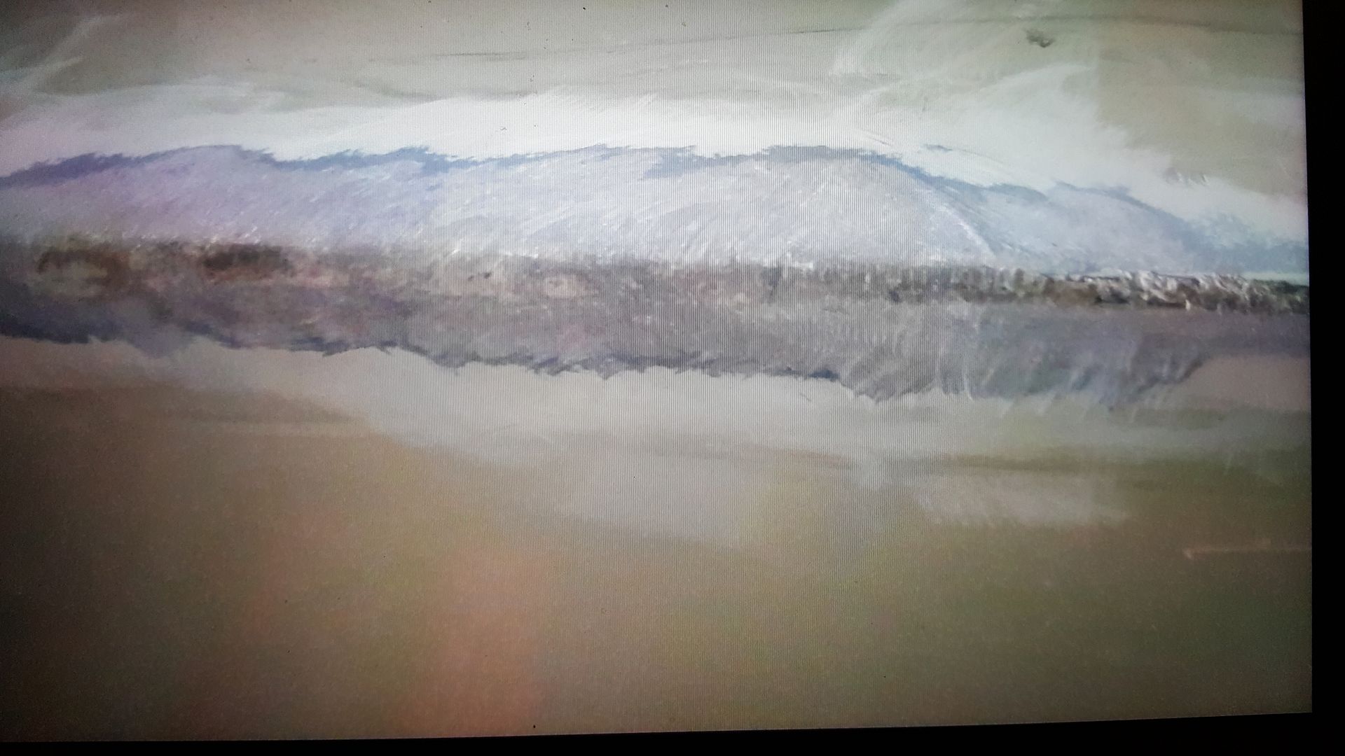

well here is another picture after grinding all the crap off ..... now just needs to be sanded a bit then time to lay the glass i hope ....

Your latest picture look 100% better. You ground it out nicely. Use Polyester and even Cabosil and 1/4" fiberglass mixture to fill in the area. It will get hard as a rock and then you can feather the filler in nicely and gel coat over that without any problems. JMHO

No need for any more sanding. This looks good enough. Run a straight edge on it to get a feel of how deep it is. Clean very well with Acetone on one direction and clean rags (or the side of the rag) with each pass. Use some thickened resin with cabosil + 1/4 inch glass to fill those nooks and crannies. Add the cabosil and the glass after you catalyze the resin. I would use vinyl ester resin for this job. If the recessed area can be filler with a small cut of 1708, favor this over filling it with the peanut butter mix (the common name for the thickened resin above)
After the filler hardens, use a 3 inch wide strip of 1708, wet it first away from the keel. Wet the keel and put the glass with its center line on the keel extending 1.5 inch (give or take) on each side of the hull.
Cut another peace of 1708 enough to cover the whole repair area and put it on using the same technique. After the resin cure, sand, fair and finish
