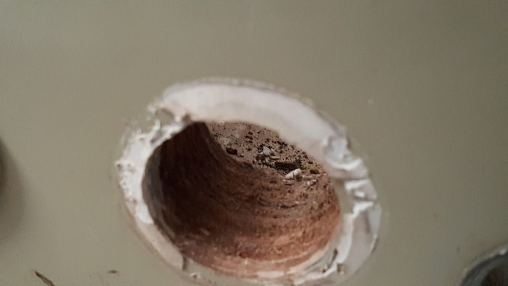

No Title
Well my color matching sucked but I will take it lol..... all done now just have to wait for it to set up so I can do the final sanding and polishing . Not a great job but not bad for my first time 😁 .... thanks everyone for the help and wisdom ! Now to get the live well pump and hoses in to finish up, thank goodness
