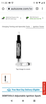

There are better ones than this but these are inexpensive and get the job done.
39,427
I have proper spark testers for testing 4 leads at a time.-----But if I needed 1 tomorrow I think I would use and old 6 cylinder distributor cap.-----Lid off a soup can and some wires.----Nothing to it.
