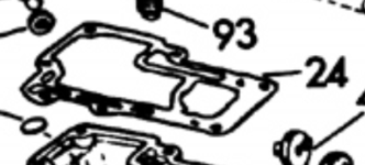

the 1955 7518 base gasket look easy enough to make one if yout are really unable to find one . ask a dealer for part 303467 1686747220882.png

303467 is the correct gasket. Should be easy to find. I found 10+ of them in a short search.
39,602
Agreed----303467 is correct.----Found those same 10+ listing as well.
