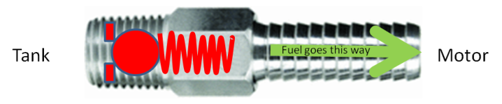

If your fuel filter is below the fuel tank pickup fitting, and you don't have a antisiphon valve on the pickup, it will siphon the tank dry.

im thinking the anti-siphon valve was removed

I can't see the anti-siphon being removed, but who knows.. maybe one was never put on..

It looks like a barbed fitting but has a spring a ball inside it
