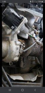

You Could try this back woods fix lol
See the light weight spring
Stops the noise hopefully or you could be looking at cam phasers...Fords better idea

This is the size You see the spring attached on below actuator on wastegate linkage going over to turbo on the left.... ...it is a spring little burry

Disregard all of the above it is for the new design...electronic actuators .....your lucky you have the old style vacuum actuators that you can adjust the wastegate.
Pop off vac hose and use a vac hand pump and pump up to 37 lbs(38 lbs opening) slowly increase if you reach 38 lbs without wastegate opening ...take wrench on nuts and adjust till just starts to open at 37 lbs .
