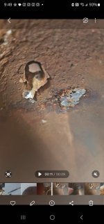

Hey everyone, I have a 89 460 7.5L King Cobra. Was just doing some general maintenance taking off the risers and manifolds when I noticed that one exhaust flapper was broken. The little rod moved from its bushing and dug itself into the inner wall of the y pipe. The other flapper on the other side was fine but kind of stuck open. So basically they're not doing their job. Luckily no damage occurred.

The grommet on the starboard side of the ypipe came loose and the pin was driving into the inner wall of the y pipe. I'd have to sand down the damage and do some work with some JB weld to make it fit again. Also the flapper on the starboard side was stuck open. I had to give it a good amount of force to get it loose so it definitely wasn't doing its job.
I replaced both of these flappers about 2 years ago with OMC OEM parts. I was just looking for an alternative since it didn't seem like these were working very well. If i replace with OEM again, I'm going to want to make sure they're still functional, and the only way of checking them is by removing the risers which can be a hassle
