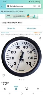

Looks like a Faria F33103 . . . why do we always have to do the parts lookup for people? It seems like they don't come with the black rims though . . .
Maybe try Great Lakes Skipper.

32905 Euro after about 1 hr I found it I think. Waiting on stingray or faria to confirm now.​
