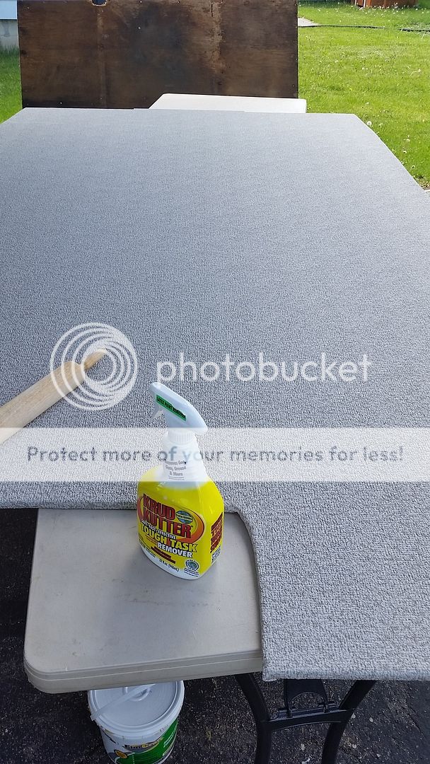

I started tearing the boat apart...following all of your wonderful restore threads...big thanks to everyone! I did run into a little problem with removing the front plexi-glass windshield - so some direction in that is greatly appreciated. I got the flooring all installed - 3 pieces joined together with epoxied wood supports ( sorry forgot to take picture) then marine nautolex glued on. My lovely wife and my brother both helped me lift the one piece flooring onto the boat. All looks really good. It's getting late, will update more tomorrow.

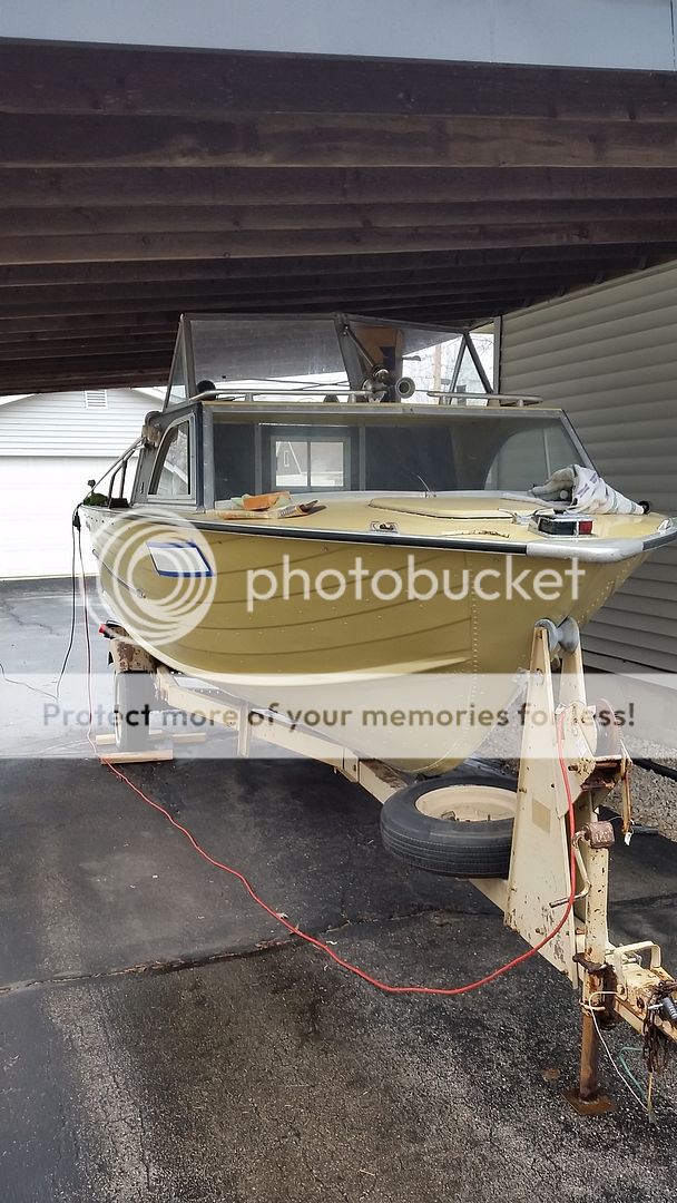

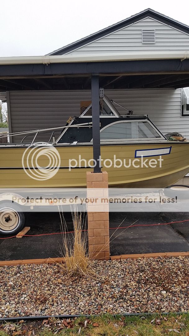

Here she is under my car port, starting my tear down:

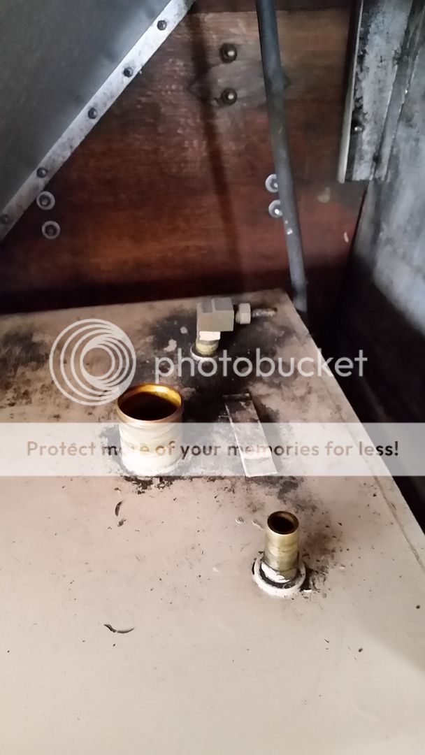

Disassembly of 18 gallon fuel tank and hoses:

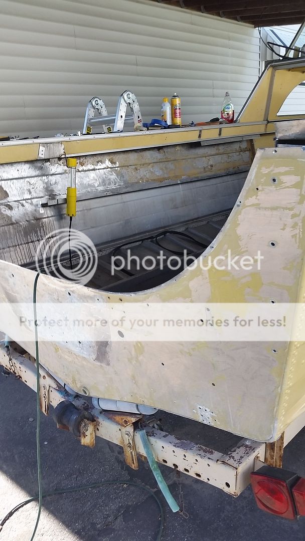

Motor removed/ Removing glue from the sides / started stripping paint:
New walls in place:
One piece flooring glued:
