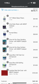

Pulled the trigger on some supplies today. I decided on vinylester. Did I miss anything? I already have PPE. Next big spend is tools and the garage.
Vintlest will allow you to gel coat , so you're good there. Do you have any fiberglass? And how are you going to work on this if you don't have an area to work?
