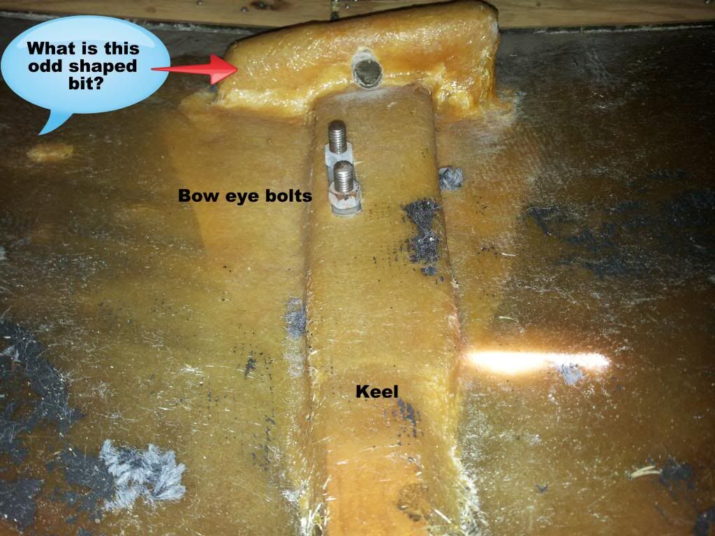

Something weird in the front of the hull just below the cap... the two studs with the bolts you see in the pic are for the bow eye bolt. I'm not sure what that odd shaped thing is in front of that though?
Not sure why, but my comments on the image aren't showing up. If you click the image you'll see my commentary. It's the weird thing in the background above the bolts though.
