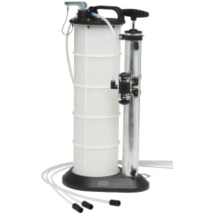

Pump used:
Quicksilver 802889Q 1 Oil Drain Pump
Took about 15-20 minutes to pump out the oil from the dipstick port.

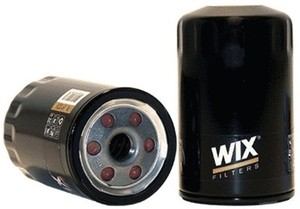

Old Oil Filter - Mercruiser / Quicksilver: 35-883702Q
thumbnail
New Filter - WIX 51036
Difference - it is a little longer than the Mercruiser / Quicksilver filter by maybe an inch or 2.

That pump may be why it took so long. A good vacuum pump will work better like the Topsider. I have been using one on my '88 OMC 4.3 and fabbed up an adapter for the male garden hose threads on the top of the dipstick tube. With this, it sucks out all the oil in less than 5 min. I use a Merc filter or Sierra, whichever is available and use the cap wrench as you did.... Oil change pump.jpg

NatedoggAZ
Mar 7, 2018
182
That topsider looks like a good idea for sure!
I hope I am done changing the oil for this season though!! =)
Will have to look for it probably around this same time next year - looks to be about $45 - $55.
I already spent about $40 on that quicksilver one - urgh...

Like the OP, I used the standard manual Quicksilver pump on my 5.7 and it went quickly, maybe 2-3 minutes. Now, the pump was very hot to handle after the heated oil came up so I had to use gloves to hold it.

Wow - maybe I just got a bad pump... or could not make a tight enough seal due to where the dipstick port is....

Anything but a Wix filter or Fram (Orange can of death). Have you ever cut one apart and compared it to: MerCruiser/Volvo/AC Delco/Motorcraft, even NAPA? You won't like what you see.
Just saying from having done so.

@ DRS4164 - There are threads on the dipstick port - It was a little difficult to thread it on because of the location - but I was able to turn it a bit... I didn't use a wrench or anything to tighten it - just hand tightened the pump on the dipstick what I could...

@ Lightwin 3 - I have seen and read that the WIX filters and the NAPA Gold filters are identical. To get the NAPA equivalent for a WIX - you just apparently drop the first number (WIX 51036 to NAPA 1036)
https://www.napaonline.com/en/p/FIL1036

Wix way better than Fram. I thought he Wix internals looked pretty good.

You do realize that Quicksilver does not make their own filters right - they are farmed out to the lowest bidder - whatever manufacturer that is.... Most likely WIX or maybe even Champion, FRAM, Puralator...or even Santa and his Elves - and it probably changes from year to year...... I'm not trying to get into a debate over oil filters - frankly I really don't care ,.... REGARDLESS of what I READ or SEE.
Comes down to personal preference and cost if you are cost conscious...
I have a 30 year old boat - so WHATEVER filter I choose is way better than what was available at that time due to changes in technology and manufacturing standards!
My point was that NAPA Gold and WIX are the same thing - NAPA Gold filters are made by WIX.
Of course the manufacturer wants you to buy their brand... but buying an automotive brand is just as fine

It doesn't matter who manufactures them, it's to what Spec's they're manufactured to.
As an example, there are only two lead/acid battery makers in the US. Exide and Johnson Controls. Spec's for different brands vary widely.

Wix are great filters and the are identical to the Napa ones. They even share the same part number.
I only use Wix on everything I own.
