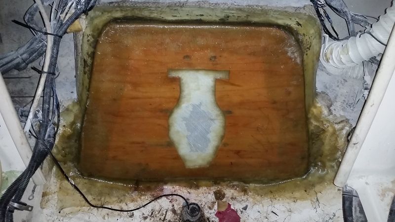

First time replacing transom wood

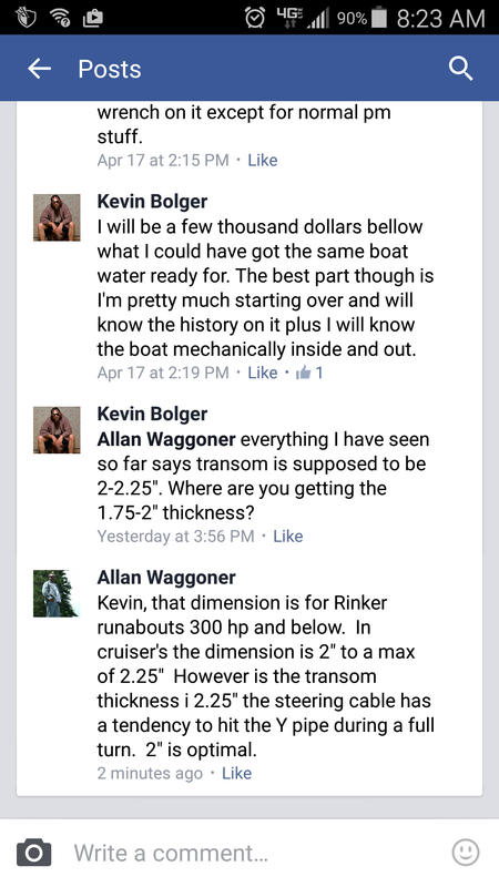

If I make the transom 1/2" thicker than the manufacturer did, will I run into issues of the splines of the out drive moving a half inch out also?
silvert
May 12, 2013
120
Just thinking out loud here....but mercruiser specd the 2-2.25 inches, that's where they want the spline to be in the coupler. I'm sure rinker didn't get a custom length shaft when they ordered the outdrIves

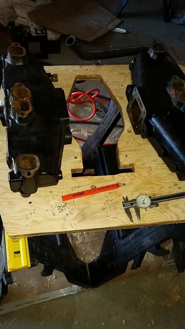

Got two of cutouts glued together today. Used drywall screws that I will remove later, to hold it together. Put my old manifolds on their for some extra weight. Final measurements came out to 1.08" of thickness, was only + - .02" around the keyhole. Pretty happy with that.

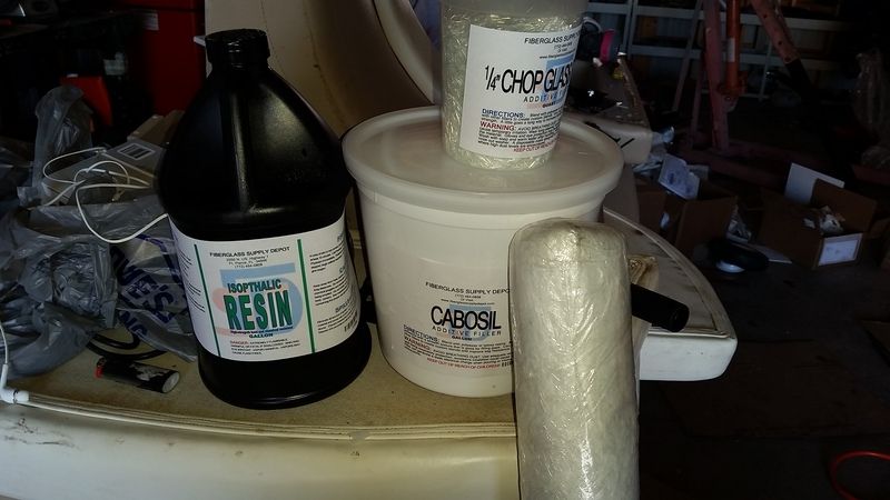

My fiberglass supplies came in also today. this is just a small amount of what I got. I have 3 gallons of resin and lots more strands and silica.
Saturday I plan to glue the wood in with Pb. Only using two sheet of 1/2". Will see where that gets me. My ultimate goal is to be at 2.00" when done.
