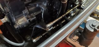

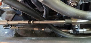

The shifter from a Chrysler and Force should work.
What connector are you using? The long or short? Pics???
Morse is just a brand name, they were used on lots of outfits, Force
Volvo Sterndrive and Chrysler inboards, Ford ETC!!
How hard is it to shift by hand? The seal where the shift shaft enters the
lower unit can be swelled,clogged and seizing the shaft just enough to stop the travel of the rod? The shift rod might need to be turned in and then out 4 turns???(maybe) check the service manual.

I attached a few quick pics. The shift rod doesn't move hard but there is a bit of springy resistance at both ends of the travel. Unfortunately I don't have a service manual, my subscription expired, maybe I need to renew that. I don't know what you mean by turn the shift rod in and back out.

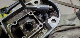

I pulled the lower unit off and the shift rod does pull in and out fairly stiff. I turned the rod in all the ray and it went 4 1/2 turns. Then I threaded it all the way out and something must have shifted inside and now I can't get it threaded back in. I suppose now I might as well finish opening it up and see what is inside. I do have one from an 85 that I know works. I don't know if that would fit this motor or not.20210521_212420.jpg

That shifter won't work.
The lower unit needs to come apart and the shift rod reinstalled n the shift yoke :(
The parts from a 85 won't work either.
LOTS!!! of service manuals on Ebay
Just make sure they're for motors made before 94 and the books a "factory" manual.
The seal where the shift rod enters the lower unit might need replacing if the shift is hard?? Easy to replace.
