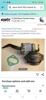

Good day, looking for suggestions on fuel pump part number. I ordered one of Amazon that said it would work however the arm looks slightly different
Jakem
Apr 25, 2021
1,099
This is what I ordered

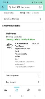

Right how ever the arm is different then the pump I pulled out..slight difference
Jakem
Apr 25, 2021
1,099
Sorry this is the pic I meant to add.
