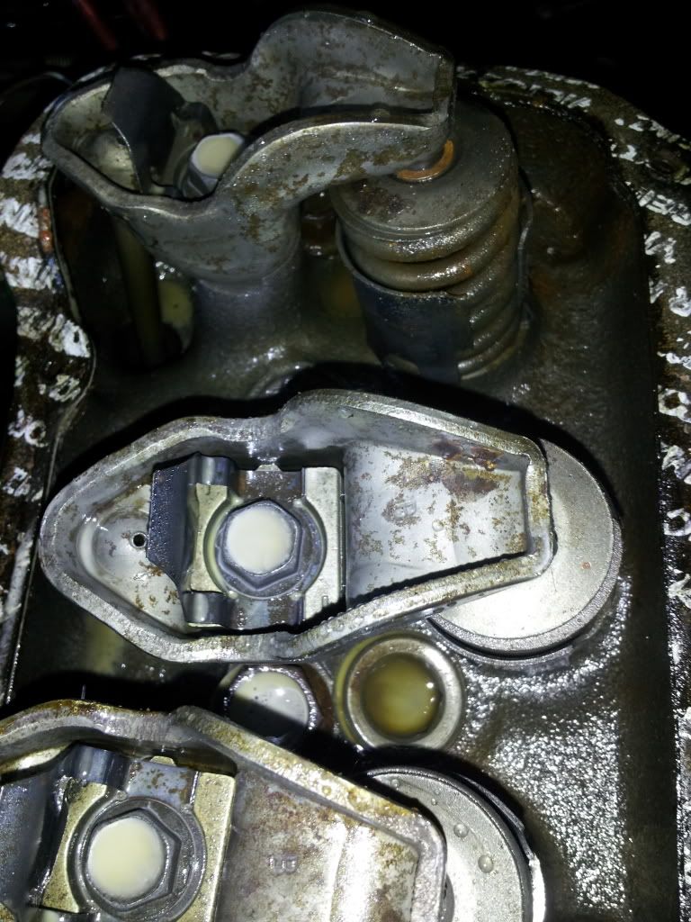

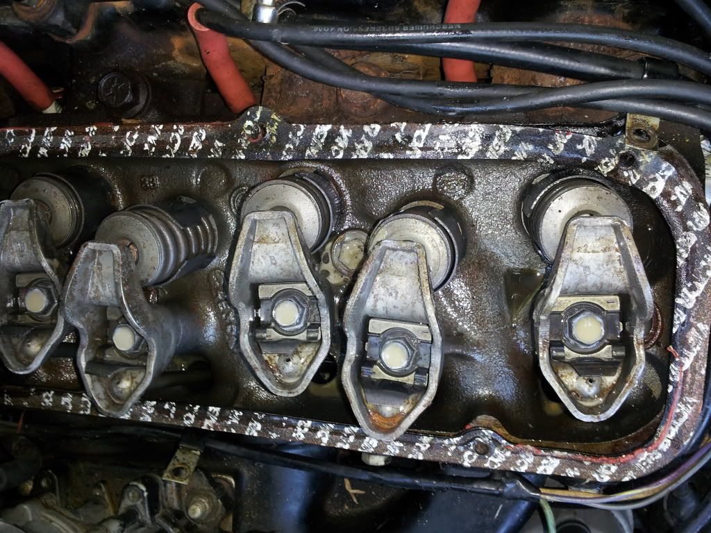

A little milky but actually is sludge free on top at least.

Looked at the photos, that oil looks milky but I sure have seen worse, and it looks like there are some water droplets sitting there. I think draining it flushing and putting on a cheap filter and some cheap oil in and give it a try. As I recall it holds about 5 1/2 quarts with the filter. Beginning to think there was some water in there from sitting.
