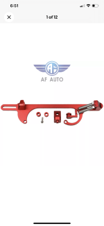

Will one of these work?

That fitting on side of metering block is for Vacuum on a car engine to distributor,Suggest a Marine carb like Rick called out

Where would that connection be at on the carb
There isnt one on an automotive carb…look at your old q jet you will find a nipple on there. On eddys it pressed into the cast at top if carb. Do yourself a favor and rebuild the q jet or get a marine carb.
