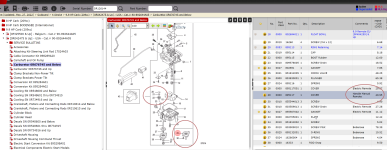

Sorry I'm a few days late. I like dealing with the parts thingies
There are 2 serial ranges of carburetors listed on the parts schematic when you punch in your serial number
0r676745 and below (correct one)
0r676746 and up If you chose this one you will only see 1 option for
Your serial number is
ENG: 0R126144 1F10201FK MERCURY 9.9 M 4 "2006"
M The M 4 after the 9.9 stand for Manual start, short shaft (15”/381mm) driveshaft housing. Tiller handle steering
@Fun Times has give you the part numbers for #44
When I look at the epc, and your carb they look the same to me. I highlighted the parts that look the same. #29 is for Tiller steering units I'm assuming maybe the wrong one was selected?
I heard back from Mercury - the part number for the carb I have appears to be 8M0176126, but I cannot find a schematic on their on-line parts catalog. They said the carb has been superceded several times over the years. Parts 44 and 29 you took from the schematics of the carbs from their on-line parts catalog have the same part number (898103224) which is the number Mercury provided to me. They declined to provide the dimensions/specifications of the o-ring unfortunately.
