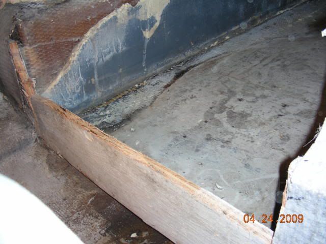

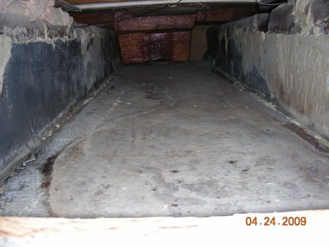

Well the tank is out finally. I had to pull it forward and cut a little over 2 ft off and then cut a piece of bracing, so that will need to be replaced. After I got the tank out and hanging in the air w/about 5 gallon of water in it, I found a small bubble of water in a corrosion spot. Not much, but then a drop or two of gas makes a bad smell. The inside of the tank was a mess, really needed to be cleaned which would almost be impossible, it was 98 X 28 X 10 inches with 4 baffles inside (115 gallon tank). Well made tank, but SeaCraft did a lousy job installing the tank on a squishy foam material on the bottom sides and then foamed it in place. If the tank had been installed with neoprene strips on the bottom, it would have lasted another 20 years if you figure out some way to clean the inside.

I really found the leak a little while ago. I was cleaning out some of the foam on the tank deck and found that the starboard rear corner foam really smelled like gas. I has set the back part that I had cut off on top of the rest of the tank and was washing down the inside, found several corrosion indentations on the inside, but notice water drop forming on the rear portion of the tank. I then took a putty knife and scraped the outside and here comes a pee hole with water squirting out about 2 inches. Sure glad that did not happen on the water, but it was ready to pop. Then instead of dealing with crud in the tank, I would have been dealing a bilge full of gas. I have an outboard and and at that time, the float switch on the bilge pump wasn't working (just fixed that since the deck was off). Guess I avoided a disaster in the making.
I would post pictures but haven't mastered that yet. These are links, just click on to see pictures. Lot less space taken up this way to.
