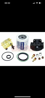

They do. There is even a mercury part number for the racor water separating filter. Apart from that…I’m certain further on it…just because I have one fitted 😂. It even has the option to plug in and connect to the alarm system on smart craft monitoring…or an alarm in general. Great bit of kit.
As for the filter labelled as water separating (the very general common fitted type with no bowl)…they can absorb and deal with the mildest of water content…just…but anything more than a thimble…they are saturated and rendered useless.
