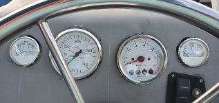

I disconnected the battery, and the gauges stayed the same. I notice the fuel gauge is closer to accurate with the key off, but normally it's below the E line when off.
Pic 1 is battery connected, key off
Pic 2 is battery disconnected (no change)
Pic 3 is battery reconnected, key on.
What is this telling me?
On the over voltage question, I tested my battery before doing anything, it was at 12.4 volts. In the video with the multi meter, it's connected to the battery and showing it pegs out about 14.2 volts (engine off then running). In the video showing the volt meter, you can see it pegging out above 16 volts (again, engine off then running).
From what I get out of the over voltage test, I don't think it's an over voltage issue. I think I'm testing it properly, but should I be testing it at the alternator, instead of the battery?
Hmm, looks like your gauge is reading 2v too high. Next step is to measure the voltage at the gauge. I'd probably check with the wiring on, and if the DVM is high I'd disconnect the leads from the voltmeter and remeasure. Lastly, I'd run a ground directly from the battery. Set the DVM to DC volts and measure between that jumper and the ground wire(s) at the helm--there shouldn't be any voltage between them. Do that KO/and engine running.
