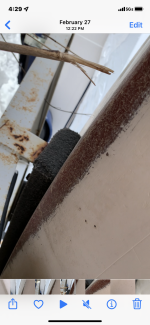

Mark1971
Mar 26, 2022
10
Figure I would post a pic
  • IMG_5614.MOV
52,688
you have some pin holes. I would do another layer on the areas with the pinholes.
