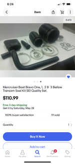

What are your guys thoughts about the SEI quality kits like the one pictured?
Chinesium copies. You get what you pay for. No one is going to tell you how wonderful aftermarket chinese rubber is, whether it is Sierra, SEI or one of the other sorta nameless brands. You just gotta jump one way or the other. Pick your poison.
Strong sentiment that oem merc are longer lasting and better fitting.
if you want to try a less expensive your call.

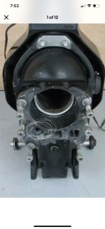

Anyone know where I can get that plastic insert that holds the water hose to the housing?
alldodge
Mar 8, 2009
43,949
Search for part number 41674T it will show up in several places under $5
ericcarr
Jul 27, 2009
293
Is tgat the part number for the hose end where it’s circled?
