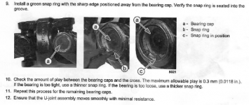

Thats what I did using this press and bigger socket on the other side (like in your great video)
1. Pressed one cup slightly deeper to have space for the groove, put the clip into the groove nicely.
2. rotated the yoke 180*
3. then pressing another cup and tryin to fit the clip - No luck... its almost there, missing maybe 0.01mm or something
I was wondering about sanding the Clip a little
now its 1.50mm tickness same as the old one so no idea why its not fitting
I have found also instruction sheet from OEM Mercs and Ive followed almost the same steps.
