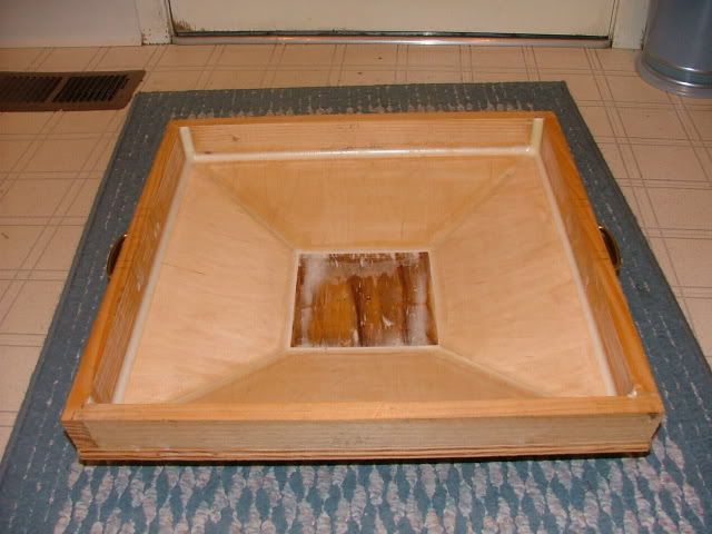

Anyone use these? I mixed up a batch for filleting on a concrete form. It seemed like it took a lot more 'bubble' to get to peanut butter than it does for cabosil.
Anyway, I mixed it, applied it and subjected it to my 'heat oven' (cardboard box with space heater aimed at opening) 'cause it was too cold out and I wanted to continue working on the form/mold.
A day and a half later I went to sand it down and the although it appeared dry/cured, it just rolled off bits and pieces as I sanded it. I thought maybe my epoxy (3:1) was getting old but for the next batch I just used cabosil and I was sanding away nicely, six hours later.
Is this a normal characteristic? I thought it was the stuff to use for easy sanding.

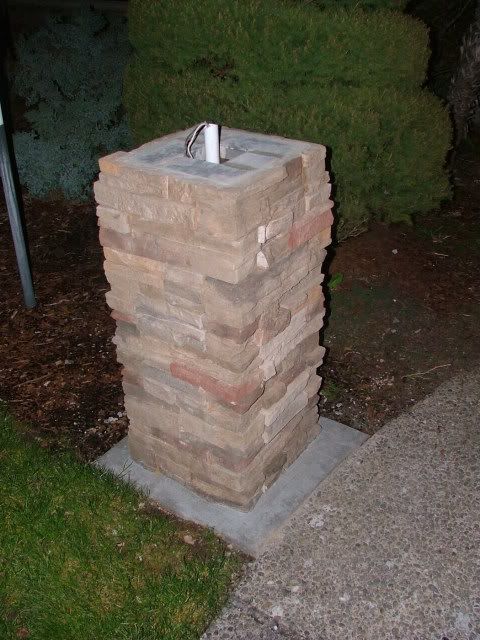

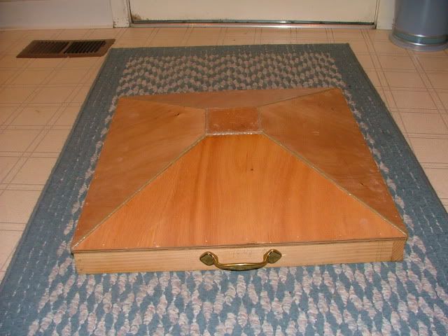

I'm making a mold for two entry walk concrete light pier top caps. I could not find the size, shape or color I needed so I decided to cast them myself. I originally tried to do the filleting with bondo but it was leftover stuff from working on my sons car about 4 years ago. It seemed to want to cure up rapidly after I mixed it but never dried once in the form. I had to scrape it all out and re-do it with the epoxy.
I'd hate to add up all the time I have in this. The caps better come out perfect.
