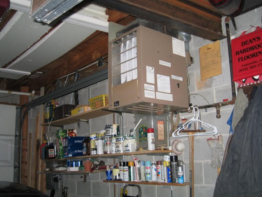

I'll throw in my 2 cents here. I used to run a kerosene torpedo heater but it was VERY noisy and stunk. Not to mention the lack of temperature regulation and possible safety issues. I needed to find a better way.
My garage is 25x25 and attached to the house, so I ran a new gas line from the basement and some double-wall vent pipe thru the roof to a natural gas unit heater very similar to captmello's. It's controlled by an old mercury t-stat and will heat the whole garage up in 10 minutes.
When I'm not foolin' around in the garage I have the t-stat set to maintain 45 degrees because I have water in the garage and the attic above holds stuff I don't want to freeze.
So far 9 years and I LOVE it! The heater is the tan box hangin' next to the I beam:
That looks like it could definitively warm things up quick. I only have 8' height, so the low profile models is what probably works best in the garage.
