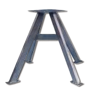

Lowlysubaruguy
Dec 3, 2012
514
Another option since your not going back with something similar to its original would be similar to these. These are popular in guide boats here in the nw and some will support much more than 400 plus pounds. The nice part in your case is your not relying on your floor to take the brunt of the load in a small area No screws unless you find you want to anchor one or two legs. There are many brands and custom builders for these this is just an example
