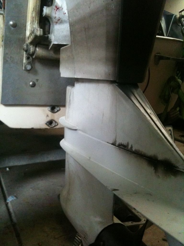

We would need a side pic showing the bottom of the boat and the anti vent plate on the motor in full down position. It should be level with the bottom of the boat. If you have power trim, maybe tipped slightly up on front of anti vent plate. This will plane quick, then trim the motor out, or up a bit.
Sabbath
Feb 27, 2011
122
Re: Help get my boat running true!
As asked for, here are the pictures:
This is from the underside of the plate. 2-3mm from the underside of the plate. When i measure from the top, it's exactly even
NSBCraig
Aug 21, 2007
1,907
Your motor does look low, start at the anti ventation plate 1" above the bottom of the hull. But then that's probably why the aluminum contraption is back there, someone was tryin to get it right.
This will help all around performance, but not really porpoising. You should buy some smart tabs. Their only $100 so I don't know where boocu comes from. Do a search on here and you'll find countless threads of people telling you how well they work, and check the Smart Tabs website it explains it all.
I don't know why you would be overpowered (or way overpowered) either lots of boats that size are rated for a 115 at worst your 15 maybe 20 over, but you'll have to check the capacity plate to know that. That's not what's causing the porpoise problem either way.
pretty much agree with the post above 100%. It looks a little low, but not horribly. Probably could go up a little bit. I'd also invest in some smart tabs. They are pretty much meant for boats exactly like that.
From what I see is, it doesn't look like its trimed all the way down. Cant tell from the pic. Put a long straight edge on the bottom of the anti vent plate, and see if its parrell with the bottom of the boat. If its (anti vent plate) tipped up in the back, its not down far enough.

And by the way: That Chrysler will be happiest with the anti-ventilation plate (cavitation plate) set to one inch above the bottom with the plate directly horizontal to the bottom.
Your friend's 105 has a 2 piece lower unit which sits 1 inch deeper in the water than your one piece lower unit (the midleg is one inch longer) AND his lower unit is about 3 MPH slower (for a given horsepower). That right there will account for a lot of his stability. Also, if he ever could reach 60 MPH which is highly doubtful, that lower unit will "blow out" meaning the nose shock wave will be larger than the prop diameter and it will lose all thrust.
