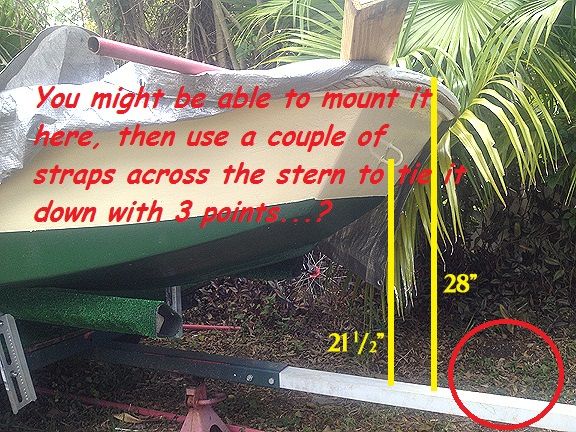

I recently installed my bunk brackets and bunks. The brackets are temporarily on there (one bolt only) until I was sure about proper height and position, and so on and so on. This pram has a very curved bottom, and although she sits on the bunk boards fine, the boards only support her for a minimal length, so she has a kind of rocking horse groove if you've had a few beers and push on the bow or stern.
As presently configured, I have around 4" of clearance between the lowest part of the keel and the bed of the trailer, as shown below. (Yeah, one of the brackets is crooked in this photo, but as I said, this is temporary.) Here's the keel:
Here is my square bow, and dimensions to both the top of the "ship" and to midway to the bow hook. (Is that's what it's called? A bow hook?)
My questions are, I LIKE the 4" clearance because it gives me room to work on the bottom, but does that make my winch post choices ridiculous because of the measurements shown? Like, am I going to need a winch post HEIGHT of 28" to make this work, or a height of 21 1/2"?
So would an angled winch post with a LENGTH of 24" give me 21" of height? And is it logical to use the bow hook height, with an appropriate stop on the winch post?
All I really need is a straight winch post for this tiny boat, not even angled, but I haven't seen any that make financial sense. So if you have any links, thanks.

All I could find was this at Harbor Freight.
1000 Lb. Capacity Hand Winch
Still would have to get a "stand off" for it...
Or you might be able to do it this way...???
Just thinking out loud and cheap as possible...;):D

Re: Help In Restoring An Old Wood Dinghy
So in other words, you think I might not need a post at all--just mount the winch on the tongue?
I appreciate your appreciation for as cheap as possible.
And PLEASE tell me I can mount the winch with U-bolts. The idea of trying to drill through that steel again doesn't appeal to me.

I wouldn't say that it is a 100% guaranteed way to do it, but this is where my thinking goes with this...
The boat can't be that heavy, heck I even thought you might be able to get away without a winch at all, and just pull it up on the trailer with a rope, but I could be wrong about that...
The other thinking is that, even if you do need a winch to pull it up, it would tend to rock towards the front and down, by using the winch mounted on the extension...once you get it located in the right spot on the trailer, you loosen the winch up a bit to allow it to settle on its belly, tie down the stern to the trailer, then give the winch a turn or two to cinch it down on the bunks...you could easily experiment with this method at home in the yard...although make sure you hook the trailer up to the car...:rolleyes:
I have never done anything like that before, but it might be worth a try, and if it works, you are good to go...If not, then we'll have to come up a way to mount the winch on a post...
And yeah, I think you should be able to U-bolt it to the extension...Maybe...:whistle::noidea::bolt:
BTW, if you decide to get the winch at Harbor Freight, look for one of their flyers in the mail or at the store...they usually have a 20% discount coupon for any one item...
L8r,gt:D

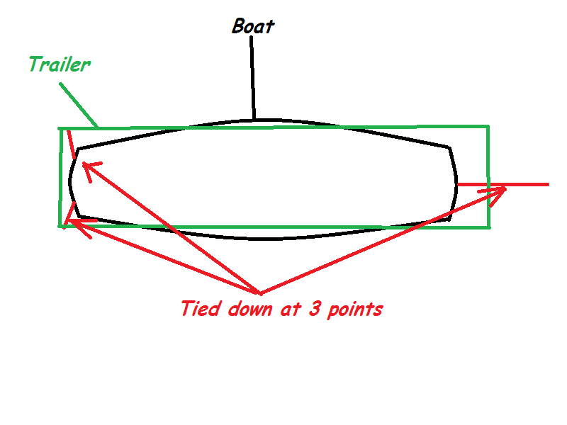

Gus, I stole your illustration and modified it a little. Time to plan my Beverly Hillbillies canopy:
Instead of PVC, I'm going to use solid electrical conduit (solid meaning not flexible, but it's still actually tubing/piping), cause I have a bunch of pieces and it's a lot more rigid. It's about 3/4" diameter.
Need to find 6 rod-holder type "things" to mount on the blue dots, with enough of a collar to supply adequate lateral support to the 6 legs. Top end of the leg will be capped, with an exposed bolt JB-welded through the cap sticking up and out.
Install my legs, get a piece of canvas from HF, and mark my first hole to grommet. Stick my bolt through grommet, stretch canvas to next leg, mark and grommet, and rinse and repeat for all 6 legs. Later, trim and stitch edges of canvas to the profile.
Keep legs and canvas stored in a bag, and attach canvas via wing-nuts. Could probably keep the whole thing assembled and just stick legs into posts when needed.
Sounds like a really good solution...I like the sound of it...
Definitely post up some pics of the progress and outcome...:)
