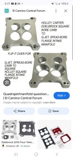

Spread bore or square bore google it you will see the diff. If speak ore you may need an adapter to line up with your square bore carb
this was my answer back yesterday but it didn't go through for some reason, "Ok I took a look it's a spread bore intake and that small spacer is the adapter to square bore. "
So I think i'll try it with my the conversion spacer and see how she runs. The wedge is a discontinued item but I may still be able to get it online somewhere. Crazy $350 usd for a wedge. Anyways I figure I'll bolt her together and fire it up. Who knows the previous owner did with timing etc. I'm sure I'll need some timing/tuning advice as well.
One thing I did notice is the throw on the throttle wasn't equal when attached to the AVS2 carb. Like it went farther back in reverse than it did forward. Doesn't seem normal to me but I've only owned I/O's and OB's so I am not sure.
