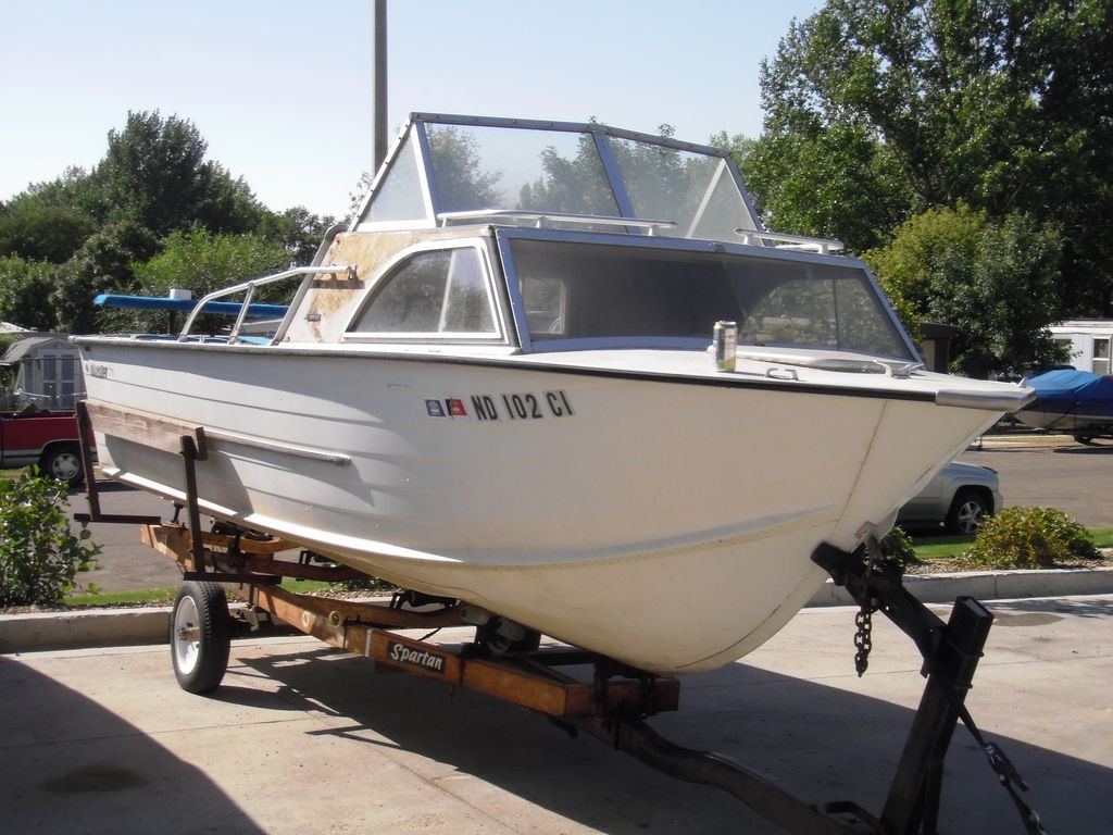

It's definitely pre-1974, as you have the older style logo emblem. Does it have a HIN on the stern?
It's all the same parts/dimensions as all the other Starchief/Chieftain 18's.

So what are you trying to identify? The year? You most likely won't find a HIN on the boat because the boat looks to be pre 1972 CG required.
Looks like a merc 120 with the MR drive that's seen better days. I noticed that the mahogany for the bow cover supports looks intact, thats great if it is. I'm thinking she needs maybe more than a repair job, by the looks of it, a total rebuild is in order. It's obvious that someone put a bunch of carpet in the boat did they also replace the decking, side panels and transom?
Looks like a great project Chief from here! A trailer upgrade may be in a good idea.
+1 on that.
Ground up restoration needed to end up with a safe, reliable, awesome boat.

Welcome to the Starmada. Great looking chief you found and glad you were able to save it from the shredder. I agree with the other guys I think your looking a complete rebuild on this one.

Yep, would really like to pin down the year, there must be some way or variances from year to year to be able to. It is a Merc 120, I can barely see it on the faded decal on the valve cover. The engine is internally immaculate, it is either a rebuild or was well taken care of. I seen a serial number plate down near the bell housing on the starboard side of the engine, will that give any useful info? The transom wood is good, no rot just some flaking paint and surface cracking. The bow supports are in excellent condition along with the cuddy cabin wood. The deck was replaced some time in its life. It isn't pretty, new wood but suffers no rot. I spent the day yesterday flushing pounds of silt out of every nook n cranny. I am pretty sure the outdrive was scabbed from while it was in the wrecking yard judging by the how clean the mating surfaces are. What years n types of outdrives cross over with this? and for that matter what exactly is the type or call out for this outdrive? I may have access to a 1978 Larsen boat with the 250 ci and outdrive. As for the side panels, do you mean the ones covered by blue vinyl down near the shins on each side?

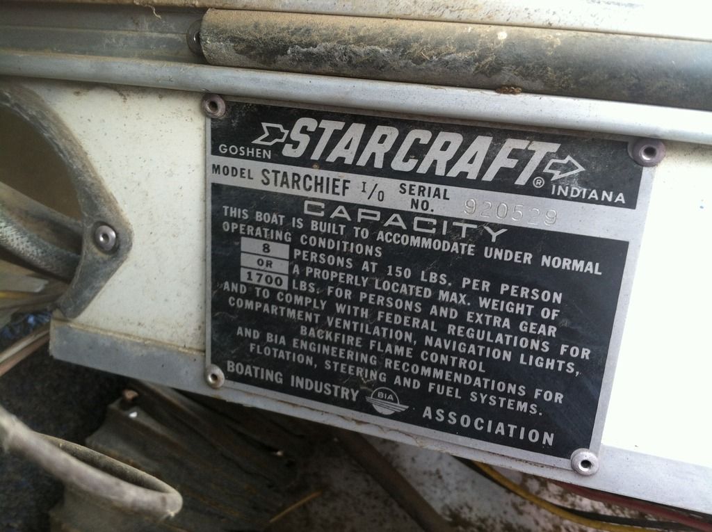

Wow that cap plate looks like new! I see your Chief has hull reg numbers on it. I take it you don't have any paperwork showing the exact year. When was the last year the boat was registered? Your State motor vehicle licensing should be able to give you a print out on the reg info that's on record for those hull numbers. I can only guess at the model year by looking at pics. Post the serials on the motor and transom assembly is any.

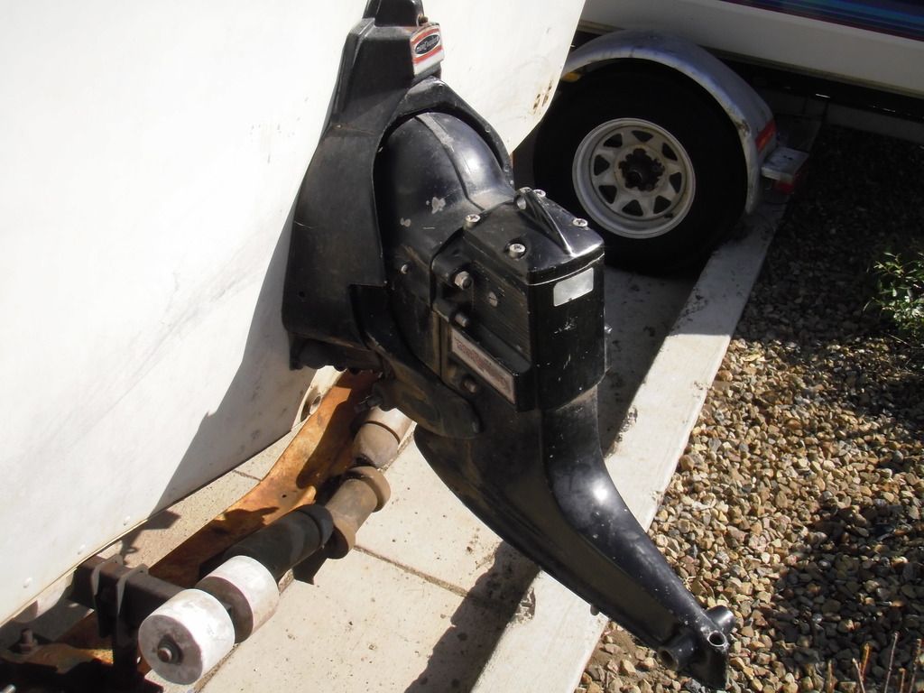

One good thing is that they only took the lower unit off the outdrive. If your upper is in good shape then you could replace the LU since the gearing for the motor resides in the upper. Yours is most likely a 1.94 ratio for the 4 banger. The 1978 LU off the Larson would be a direct replacement or you could swap it all over to your Chief. Of course a complete bellows and transom seal kit are in order for her.
You should test out the motor. If it were me, I would pull the spark plugs, fog the cylinders and then see if she turns over freely. If so you can remove the upper OD so you can get some water to the motor by putting a hose in the water inlet. Disconnect the fuel line from the pump so it doesn't suck any gunk in from the tanks and use a spray bottle to shoot fresh fuel into the carb while cranking her over. It's nice to know if you have a runner. :happy:
Found this in a hold while cleaning......It has discrepancies such as the HP rating, the serial number has a 6 in front of it for some reason, so I question that the year listed is the actual year of the boat.
Was planning on just what you suggested:) I am going out in a bit to pull all the plugs and shoot PB Blaster into the cylinders, let it sit a bit, slowly crank it then do a quick dry fire. I HATE broken rings and this method has always been fool proof. What is the OD?????? is it the outdrive?

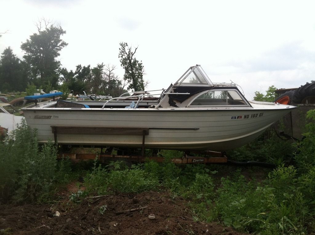

Here's a shot of it in the wrecking yard before I put new tires on and drug it out. I give many thanks to my friend whom is one of the owners of the yard for giving me the boat, super nice guy!!!!! Kinda a rare thing these days.
Watermann
Jan 12, 2013
13,843
Some guys have all the luck ;)
Yeap OD = outdrive LU = lower unit
You're picking up the lingo quick and I see you have another boat too in the pics to keep the ole Chief company. We call that MBS... Multiple Boat Syndrome. :lol:
I would pull the rest of the OD off first before firing her up so the drive shaft isn't turning gears and bearings in that dry upper.

On the OD, just remove the 6 nuts and washers then pull it out. Also looks like they scavenged the rams and lines too.
