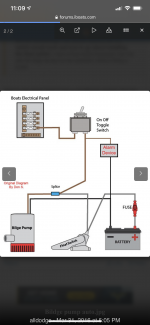

Your saying a shoreline float switch, but then mention 3 wires. What I think your talking about is a bilge pump with built in float switch?
If that is the case, use the pic Ding posted and note the 3 wires coming from the pump and switch. One is ground, the other 2 are used to turn it ON

You tie one leg of the float switch wiring to the brown wire on your pump. Then the brown wire and the float switch wire you tied togther, goes to your manual bilge pump switch.. The other float switch wire, goes to the battery.
If you use a 3 position bilge pump switch, then the wiring in that diagram is correct. The 3 position switch just allows the bilge pump system to have an off position

This is what I was thinking in my head. This setup would allow me to keep the factory on/off switch and basically wire a float that would activate if the water level rose without me there. But I can still activate the pump manually, correct?
although having a 3 way switch would be nice, I need to see if I can find a factory switch that matches the others.
Yup, that is pretty much as I described, but keep in mind if the float sticks you will burn the pump up.
