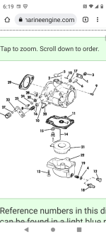

Yes this is looks like the carb. It's got an aluminum body. No plastic. #7 and 11 are the only 2 gaskets I changed along with the needle and seat.

Yes I need a manual.
Ok yes the plastic seems fine and there is a plastic covering on it that turned clear after the carb cleaning. The clear covering looks like someone cut a small piece of clear hose and cut it to put it over the black hard plastic piece.

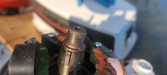

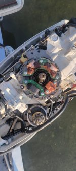

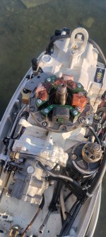

Got to the boat this weekend and pulled off flywheel the key is there.

Any chance this could be a problem with reeds inside the intake. Alll your feed back is appreciated.
