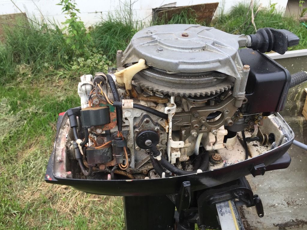

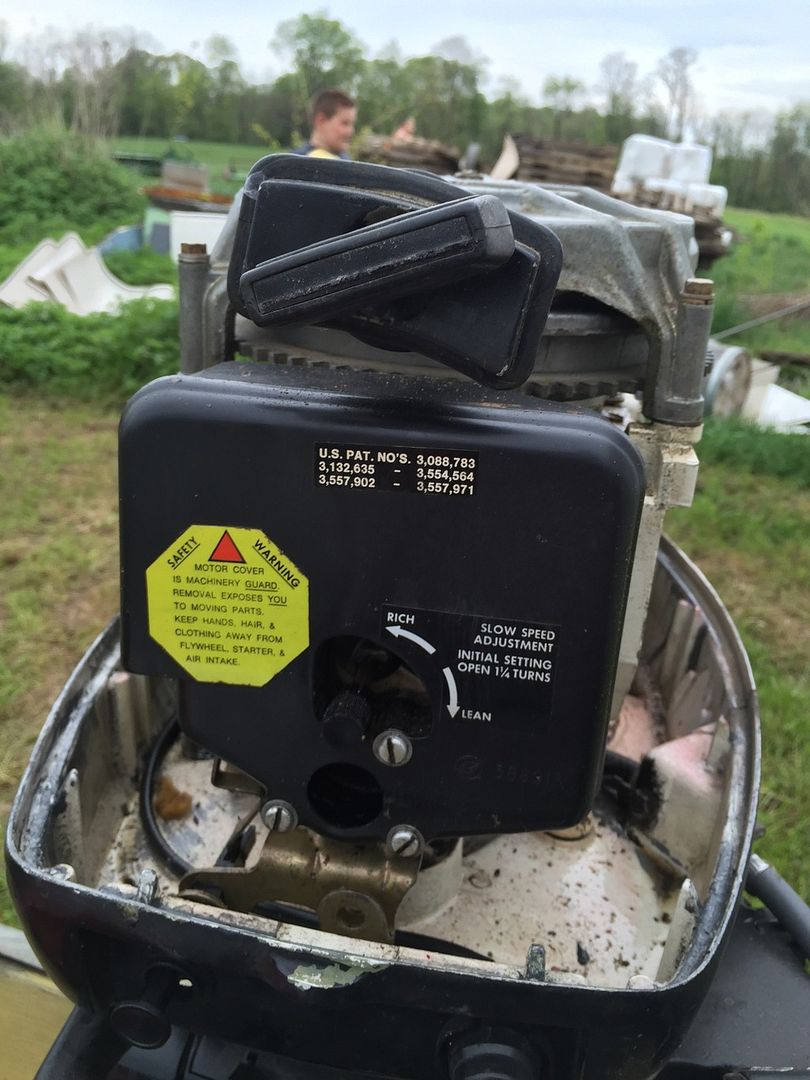

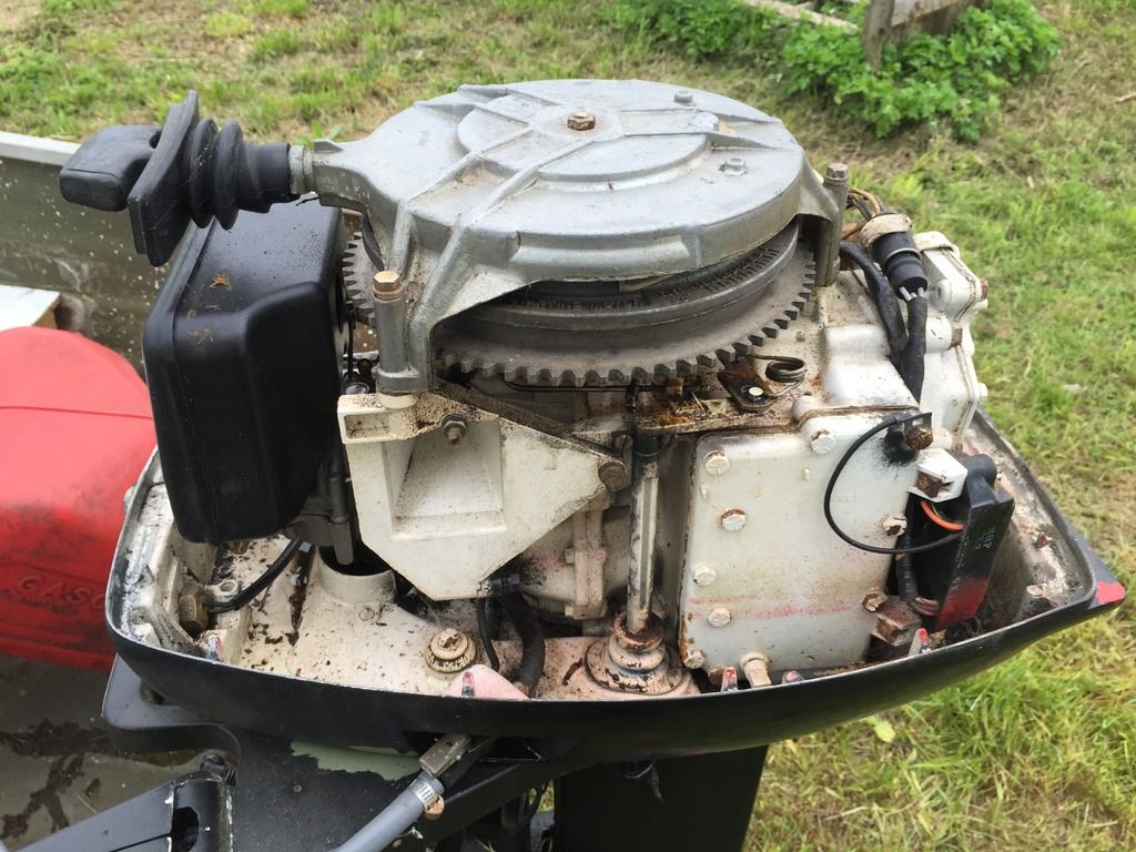

Several points of note say it is a late 1970s/early 1980s Johnson 25hp. The coils are the first generation CD type coils with the wires integral to the coil and the green painted frame. It is not a pin-drive lower unit, but it is based on the earlier lower units that were pin drive. It has a splined propshaft, with the exhaust exiting above the propeller, making it a 25hp. Also has an air box over the carb, which went away after 1981 model year. So, your motor is a 25hp Johnson, no newer than 1981.
